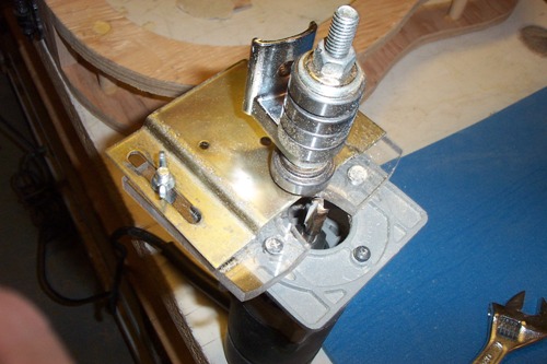

I'm in the exact same predicament as you, so I'll be watching this thread closely.
How long is the bit you're using? I notice that your 310 looks almost maxed out on height, and you've still got quite a bit of bit showing. I ran into the same thing, I wasn't confident that the router would hold it's height adjustment. I ended up attaching my 7310 and it worked out better for that. Kind of a bummer, because I bought the 310 to use on this jig. I did finally find a place that had a 2" long 1/4" downcut spiral bit, instead of the usual 2-1/2", so maybe that'll help.
PostPosted: Sun Nov 12, 2006 3:00 pm
Posts: 1157
Location: Siloam Springs, AR
I think it'll work well once we get a holding jig for the guitar nailed down. The other thought I had was making a caul to clamp the jig in a vise, then bringing the guitar to the tool instead of the other way around. I think for now I'd rather have the guitar stationary.
You might try the 2" bit, I found mine at Woodcraft, I haven't taken it out of the package yet. It's item # is 822103. link
A 1-1/2" or 1-3/4" long bit would be about perfect for the 310. 2-1/2" seems to be the most common size, though, I looked around a lot. If anyone has a good source for shorter bits...

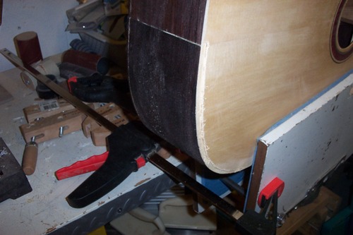

Hesh, i use my guitar vise for this and my home made jig that works much like your set up, take a look:

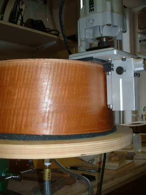

Build a vacuum holder:
The binding jig you are about to use works--I've used it for the last two years--but I'm not overly thrilled with it. It's time for me to invest the time in building a Williams-style jig, as Sylvan recommends.

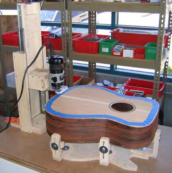

Russell came up with this neat body holding jig some time back.
Come back from your "other job" travels soon Russell - we miss you
By the way - I agree with Sylvan, the Fleischman-Williams is the dogs doo dahs
PostPosted: Mon Nov 13, 2006 3:09 am
Dave, I'm in the middle of making Russell's guitar holder, and a F/W/W binding jig, shamelessly stealing your idea for the second lazy Susan bearing so that the router can rotate. I can then use my DeWalt with the bearing follower and a downcut bit. What size bearing did you use on the router end? I know Axminster has them do you know any other good source?
